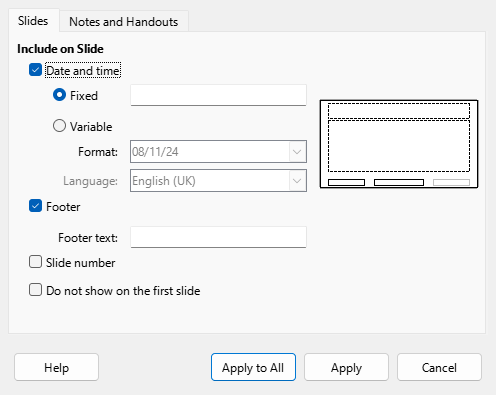

Choose Insert - Header and Footer.
You see a dialogue box with two tab pages: Slides and Notes and Handouts in which you can enter contents to the predefined areas.
By default, the Date and Time check box is marked, but the format is set to Fixed and the text input box is empty, so no date and time is visible on the slides.
By default, the Footer check box is marked, but the text input box is empty, so no footer is visible on the slides.
By default, the Slide number check box is unmarked, so no slide numbers are visible.
Enter or select the contents that should be visible on all slides.
