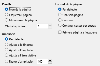

Choose File - Export As - Export as PDF - Initial View tab.
Imatge de diàleg d'opcions de visualització de l'exportació PDF
Panes
Page only
Seleccioneu aquesta opció per a generar un fitxer PDF que només mostre el contingut de les pàgines.
Outline and page
Seleccioneu aquesta opció per a generar un fitxer PDF que mostre una paleta de marcadors i el contingut de la pàgina.
Thumbnails and page
Select to generate a PDF file that shows a thumbnails palette and the page contents.
Open on page
Select to show the given page when the reader opens the PDF file.
Magnification
Default
Select to generate a PDF file that shows the page contents without zooming. If the reader software is configured to use a zoom factor by default, the page shows with that zoom factor.
Fit in window
Select to generate a PDF file that shows the page zoomed to fit entirely into the reader's window.
Fit width
Select to generate a PDF file that shows the page zoomed to fit the width of the reader's window.
Fit visible
Select to generate a PDF file that shows the text and graphics on the page zoomed to fit the width of the reader's window.
Zoom factor
Select a given zoom factor when the reader opens the PDF file.
Page layout
Default
Select to generate a PDF file that shows the pages according to the layout setting of the reader software.
Single page
Select to generate a PDF file that shows one page at a time.
Continuous
Select to generate a PDF file that shows pages in a continuous vertical column.
Continuous facing
Select to generate a PDF file that shows pages side by side in a continuous column. For more than two pages, the first page is displayed on the right.
First page is left
Select to generate a PDF file that shows pages side by side in a continuous column. For more than two pages, the first page is displayed on the left. You must enable support for complex text layout on Languages and Locales - General in the Options dialog box.
