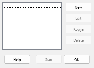

Defines a custom slide show using slides within the current presentation. You can then pick slides to meet the needs of your audience. You can create as many custom slide shows as you want.
To access this command...
Choose Slide Show - Custom Slide Show.
Custom Slide Shows Dialog

List of custom slide shows
Lists the custom slide shows that are available in the document.
Za kreiranje custom slide show, kliknite New.
Za pokretanjecustom slide show:
  1. Select a custom slide show from the list.
  2. KliknitePokreni.
Rasporedi
Creates a custom slide show.
Izmijeni
Add, remove or reorder slides as well as change the name of the selected custom slide show.
Obriši
Deletes the selected element or elements without requiring confirmation.
Kopiraj
Kreira kopiju oynacenog custom slide show. Mozete mjenajti ime klikanjem naIzmijeni.
Pokreni
Runs the selected custom slide show.
Zatvori
Closes the dialog and saves all changes.
