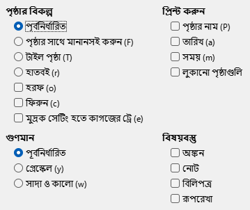

Specifies print settings within a drawing or presentation document.
পৃষ্ঠার মার্জিনে অতিরিক্ত উপাদান মুদ্রিত হবে কিনা তা নির্ধারণ করে।
Specifies whether to print the page name.
Specifies whether to print the current date.
Specifies whether to print the current time.
Specifies whether to print the pages that are currently hidden from the presentation.
আরো দেখুন কাল এবং সাদাতে মুদ্রণ করছে।
Specifies that you want to print in original colors.
Specifies that you want to print colors as grayscale.
Specifies that you want to print the document in black and white.
পৃষ্ঠাটি মুদ্রণ করার জন্য অতিরিক্ত অপশন নির্ধারণ করুন।
Specifies that you do not want to further scale pages when printing.
Specifies whether to scale down objects that are beyond the margins of the current printer, so that they fit on the paper in the printer.
Specifies that pages are to be printed in tiled format. If the pages or slides are smaller than the paper, several pages or slides will be printed on one page of paper.
Select the Brochure option to print the document in brochure format. You can also decide if you want to print the front, the back or both sides of the brochure.
Select Front to print the front of a brochure.
Select Back to print the back of a brochure.
Determines that the paper tray to be used is the one defined in the printer setup.
