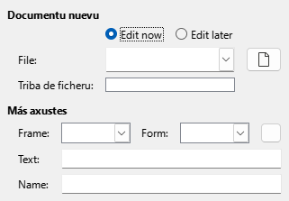

Use the New Document tab from the Hyperlink dialog to set up a hyperlink to a new document and create the new document simultaneously.
P'aportar a esta orde...
Click Hyperlink icon on Standard bar, click New Document.
Hyperlink New Document Dialog Image
Documentu nuevu
Especifica'l nome, ruta y tipu del documentu nuevu nesta área.
Editar agora
Specifies that the new document is created and immediately opened for editing.
Editar más tarde
Specifies that the document is created but it is not immediately opened.
Ficheru
Enter a URL for the file that you want to open when you click the hyperlink.
Esbillar camín
Opens the Select Path dialog, where you can select a path.
Triba de ficheru
Specifies the file type for the new document.
Otres opciones
Marcu
Introduza'l nome del marcu onde deseye que s'abrir el ficheru enllazáu, o escueya un marcu predefiníu na llista. Si dexa esti cuadru en blancu, el ficheru enllazáu abrir na ventana actual del esplorador.
Formulariu
Acontecimientos
Testu
Nome
