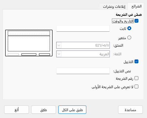

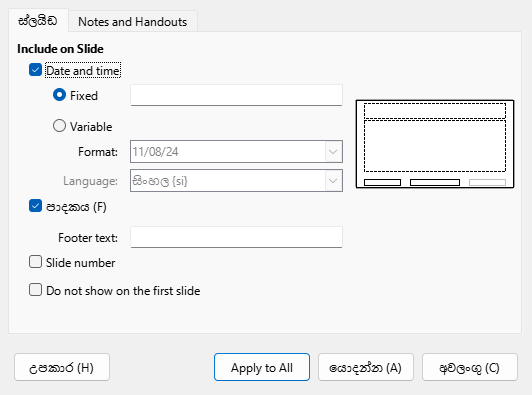

Choose Insert - Header and Footer.
You see a dialog with two tab pages: Slides and Notes and Handouts where you can enter contents to the predefined areas.
By default, the Date and Time checkbox is enabled, but the format is set to Fixed and the text input box is empty, so no date and time is visible on the slides.
By default, the Footer checkbox is enabled, but the text input box is empty, so no footer is visible on the slides.
By default, the Slide number checkbox is cleared, so no slide numbers are visible.
Enter or select the contents that should be visible on all slides.

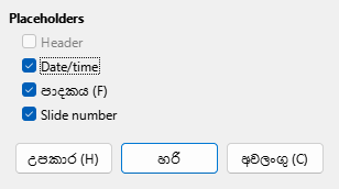

Normally the predefined elements of the master slide are set to visible in the presentation. You can control the visibility of the predefined elements by choosing
.You can add a text object anywhere on the master slide.
